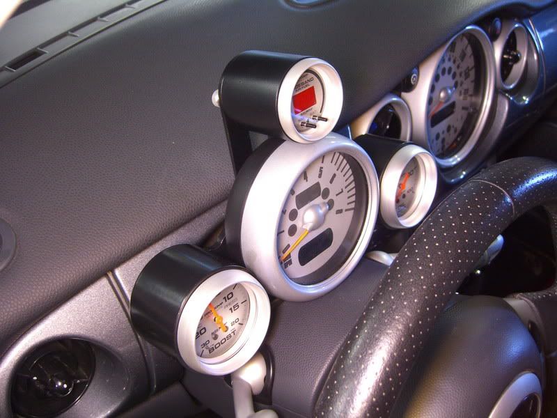

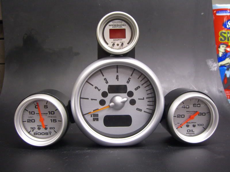

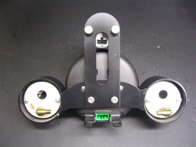

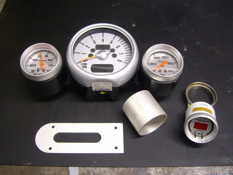

    Yesterday, I picked up the Lambda sensor gauge, and I suddenly knew how I would mount it to the steering column. You can see the two aluminum pieces I made early that morning.
    I painted the two pieces, then put everything together. I think it looks great.
    Here's a rear view of the gauge cluster.
    Here's the gauge cluster installed in the car.
    Here's my view through the steering wheel. I like to keep the steering column pushed down all the way. This shades the tach a bit, but I'm very used to that.

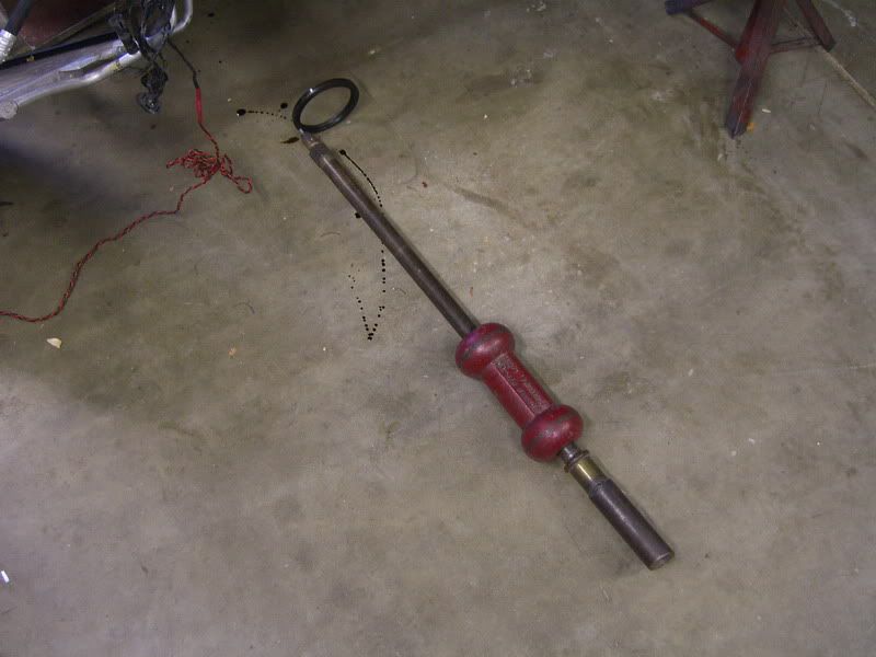

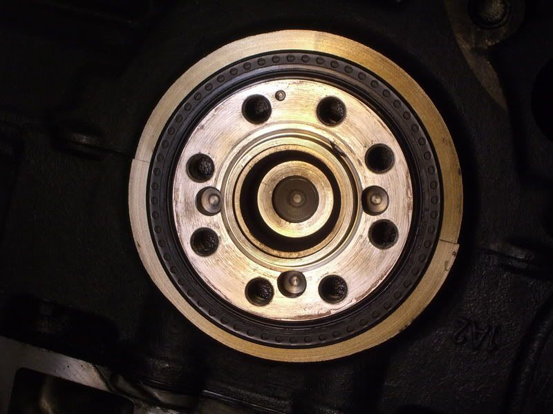

    As preventative maintenance, I replaced the rear main seal. A sliding hammer makes removing the seal a very easy task. This sliding hammer is massive overkill. I couldn't find the screw attachment for the small hammer.
    Here's the new seal in place.

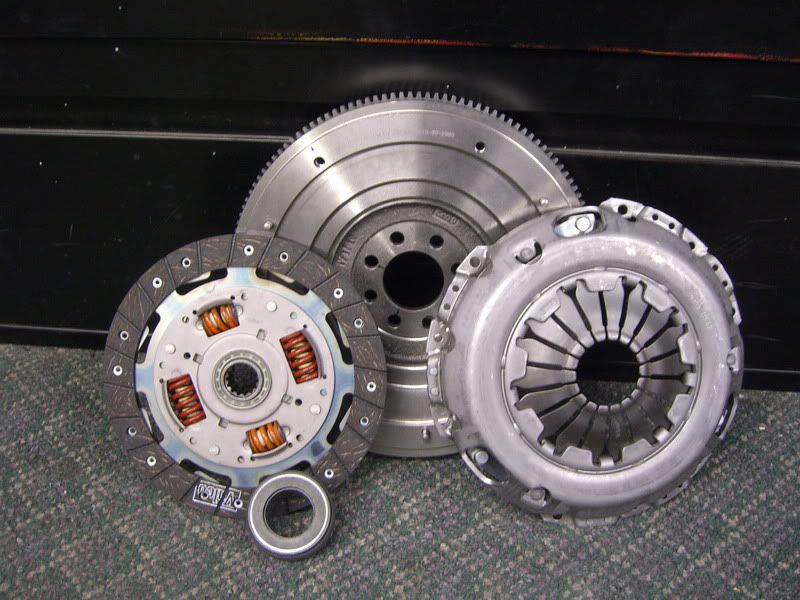

    This is the Valeo single mass flywheel and clutch kit. Everything in the kit is high-quality.

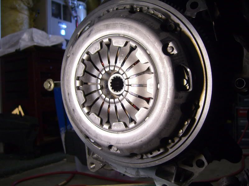

    This is the kit installed on the engine.

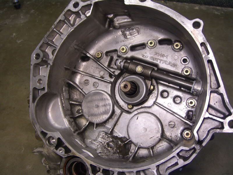

    Turning to the gearbox, you can see that the clutch release lever pivot bushings are toast. These are easy to replace - once the old ones are broken out.
    Here are the new bushings installed in the transmission (the nice white pieces of nylon).

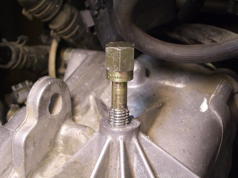

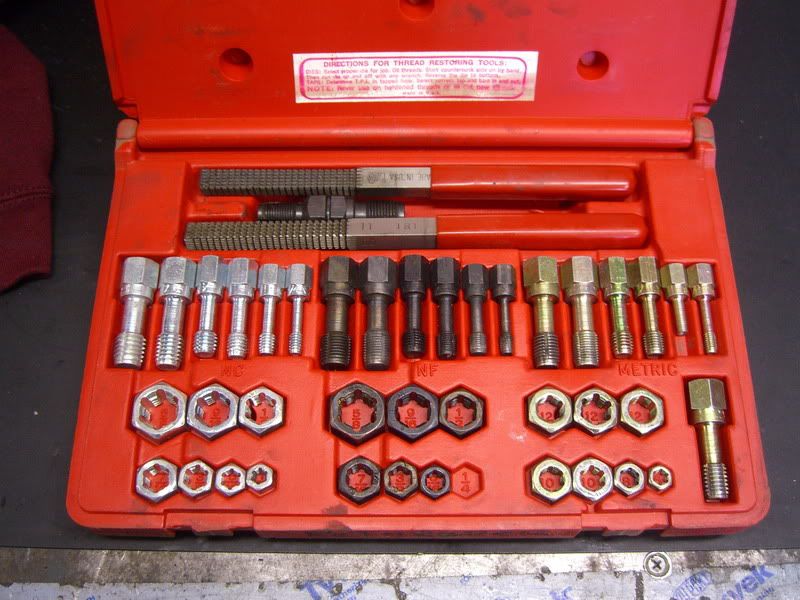

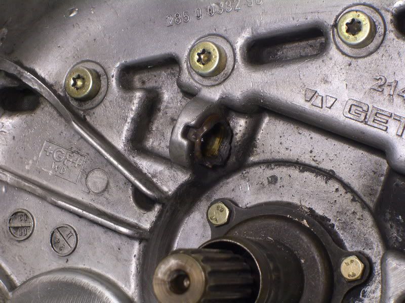

    One of the engine mount bolt hole threads went bad for some reason. One way to repair the thread is to run a tap through the hole, but this cuts all of the metal out of the way that is in the wrong place. A stronger repair is to use a "re-threader," which straightens out the threads and removes only the bare minimum of material.
    This is a Matco "re-threader" kit, with both Metric and SAE Inch tools. There are lots of other kits out there.

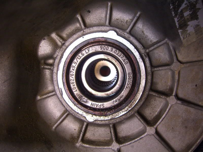

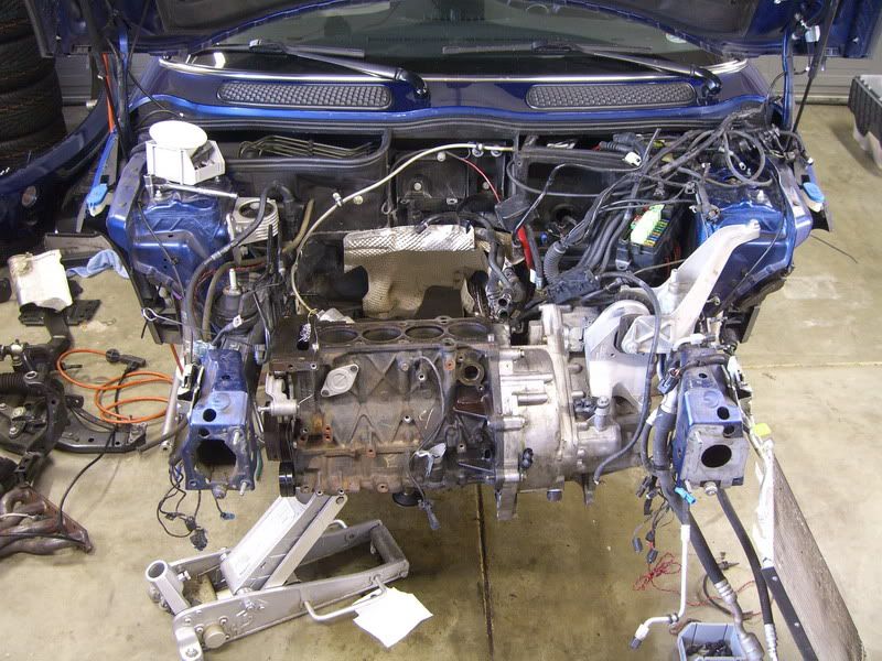

    After mounting the transmission (a miserable job to do alone), I noticed that something in the past had damaged the drivers side output shaft seal. Fortunately I had a new one in stock, so I replaced the seal.

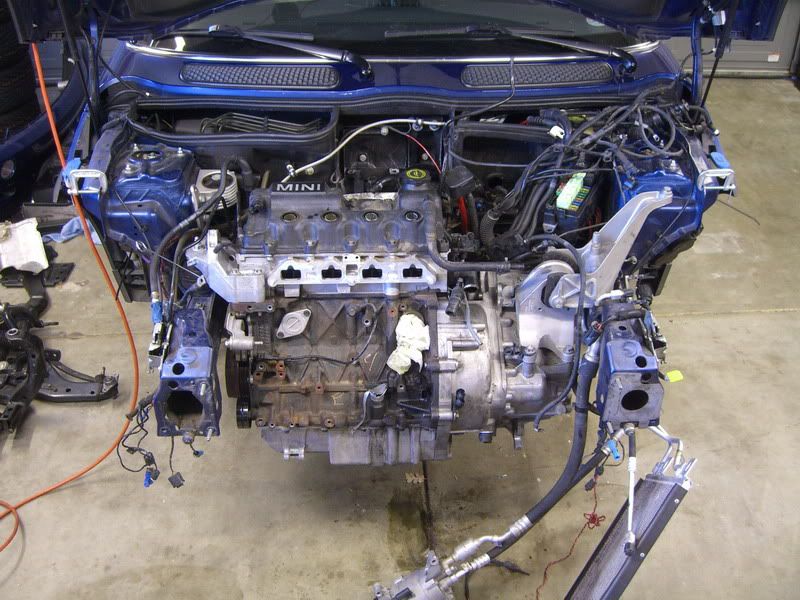

    Here is the car with the transmission installed. On to the oil pan gasket...

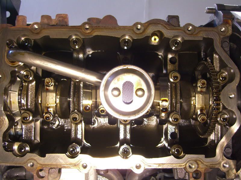

    Here's a view up into the engine with the pan removed. Nothing strange to see here.
    No head, no pan, no exhaust. This is where I stopped for the day.

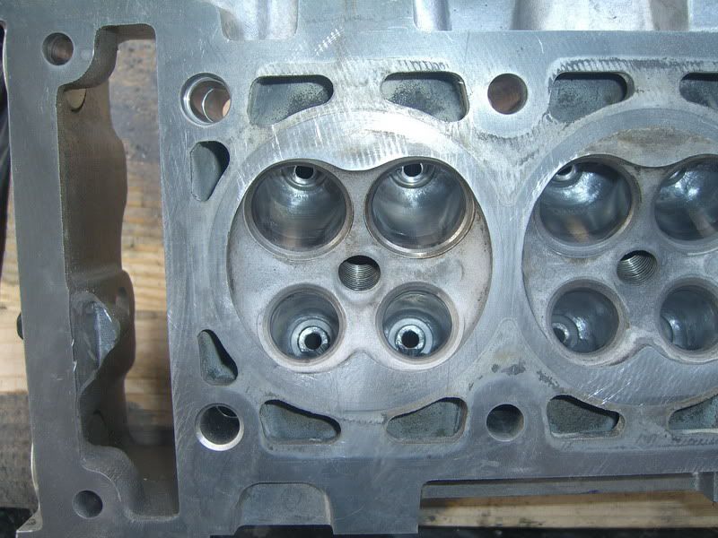

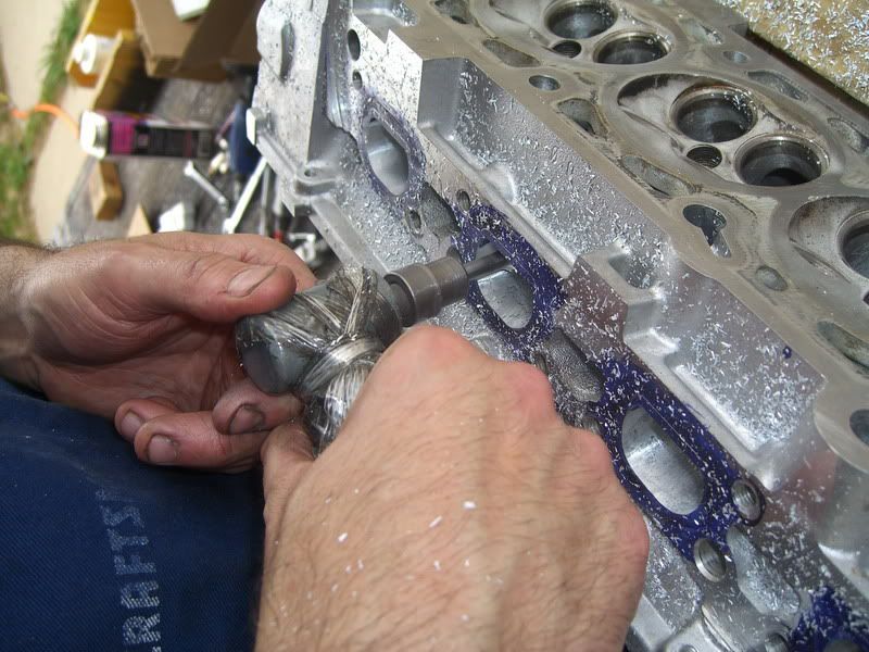

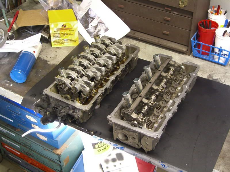

    The original head is on the left, and the newer ported head is on the right. Actually, I ported the head a few years ago, and it was installed on Scott Bibbee's MINI Cooper for several years. Man that car runs well with this head. Unfortunately, a spark plug thread was stripped out, so Scott sent the head to me and bought a Thumper head to replace it.

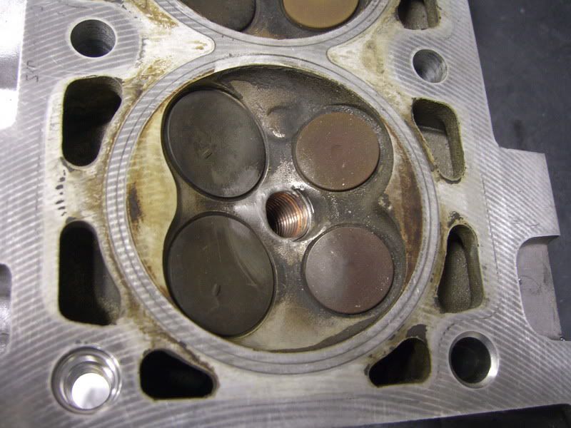

    I repaired the threads with a Timesert thread repair insert. The kit (with several preparation and installation tools) is expensive, but the results are fantastic. I blended the tip of the steel insert into the head so that there would not be a sharp steel place that could initiate preignition.

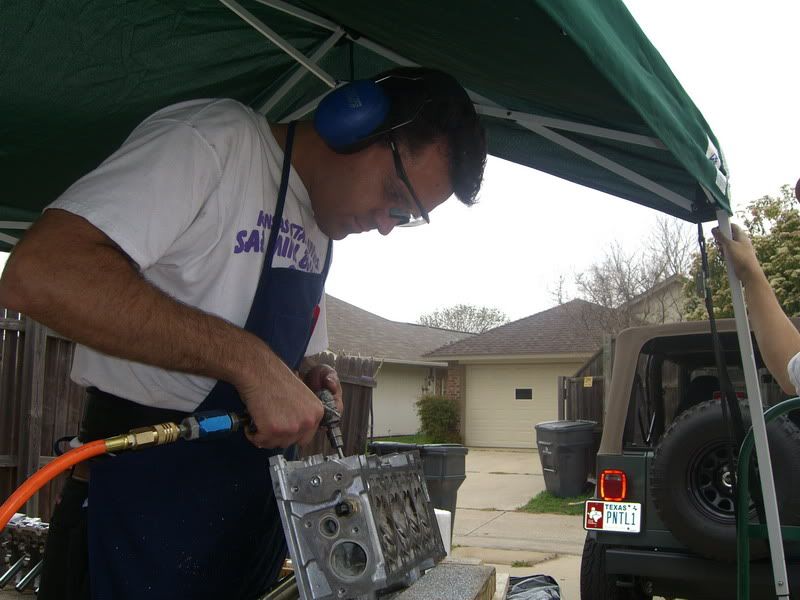

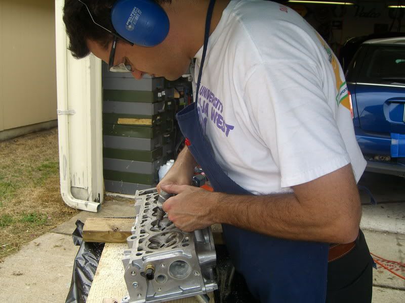

    Here's a shot of me porting the cylinder head.
    This is another shot of the porting work.

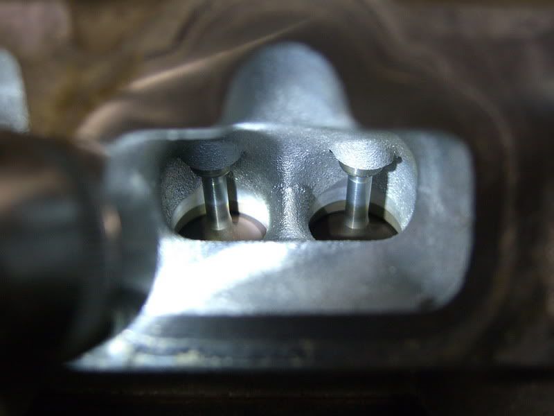

    I do all of the porting with carbide cutters, flapper wheels, sanding cones, and so on. Using a CMM, a CNC machine, and a CAM workstation (like Mastercam, for instance) to design and produce CNC-machined ports is something that I am capable of doing, but the cost in terms of both time and money, even if I had free access to some of the equipment, would be too high. Besides, I think hand-ported cylinder heads work extremely well.

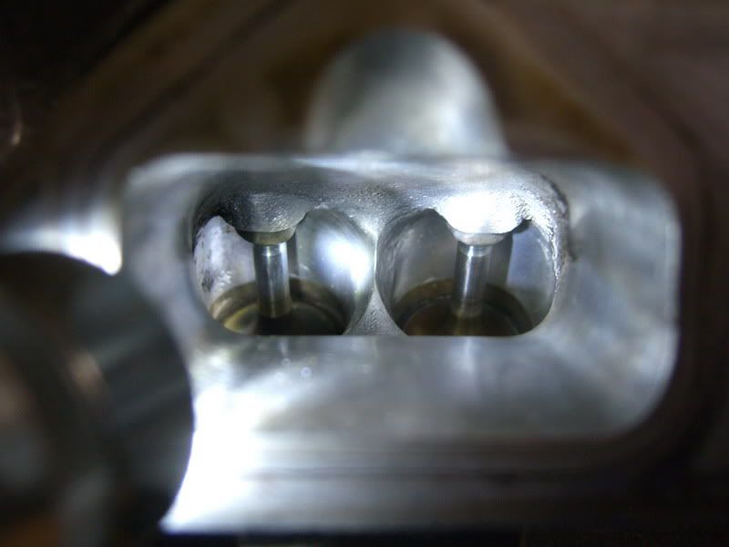

    Here's a shot of the finished product looking down from the combustion chamber. I'm not a fan of mirror finished for three reasons. One, they take a LONG time to produce compared to the first 95% of the port work. Second, fine port finishes sometimes produce more flow, and sometimes they do not flow as well as a matte finish - and only the flow bench and the engine itself will show which one is better. I do not have a flow bench, so I opt for the easier finish. Besides the difference is always small. Finally, I. Just. Don't. Wanna.
    This is a close-up shot of the ports under the valve heads. Actually, this is a head that I ported earlier than the one I have now, but the ports are about the same.
    Here's a shot down an intake port.
    This is a stock intake port for comparison. Not too bad, but a bit rough-looking and somewhat restrictive.
    The left port is a stock intake port near the valve. Bleah! The right port is rough-ported a little.
    On the left is a rough-ported, unfinished exhaust port. On the right is the stock port. The first time I saw this, I wondered how in the heck the MINI makes the power it does with this lumpy casting in the way.
    OK, that's enough for one day, I guess!

    Yes, almost a quart can be delayed on the head before spilling over the cam sprocket side. The block and a few other areas need to be addressed.
    A windage tray is one component of the systems approach needed.
