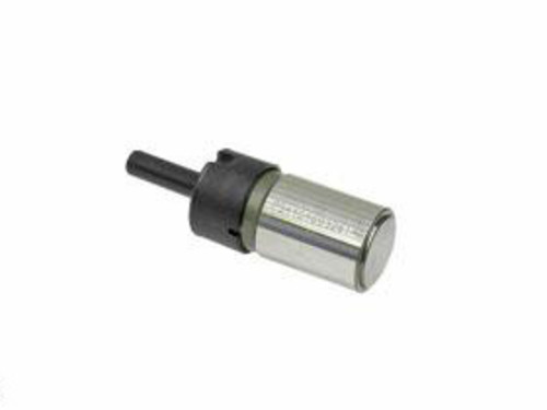

    the R53 CAN have a timing chain tensioner issue (know from experience) and it is oil-pressure controlled so it MIGHT have been your problem. But if your oil pressure is now normal and you still hear the noise the tensioner might have gone. If you replace the "usual" one and still hear the noise - check the other side. (you'd have to ask Way of Way Motor Works if you want more details than that...)
  6. BlimeyCabrio
    There is a screw plug on the rear of the housing containing the timing chain, beside the oil filter housing. The chain tensioner is under this plug. Parts 6 & 7 below:
    This is on the far passenger end of the block, where the belt is, etc. The plug is down low, to the right (passenger) side of the oil filter housing. You can't see it from the top side, but you can reach down and feel it. You can most easily access it by removing the wheel well liner. Just did mine this past weekend.

    11 31 7 510 801

    hi chaps ,I changed the chain tensioner £31.00 from main bmw dealer so not to bad but made no difference haha how I laughed :cryin: took the car to a localish mechanic they put it up on ramps reckon its water pump which confirms why its using a bit of water nowadays .I reckon I can do this myself WISH ME LUCK :fingerscrossed:

    Thanks for the reply ,I was trying to describe a screw in plunger type of tensioner ,I presume its like a piston type thing , so it screws into the block from the outside ,but where can I find it on the block ??? ,been to a good mechanic today and he said engine sounded ok to him ,im not being paranoid there is a rumble and I want it gone !!
