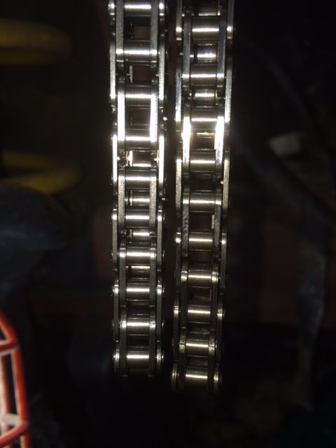

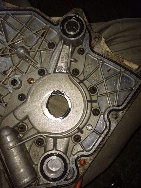

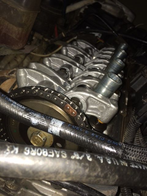

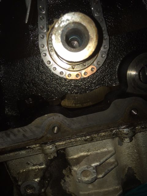

    I got some rain free time last night. I matched the link pins at the top of the chain but at the bottom the old chain was more than a half a link out. Also I matched up the timing marks but after a few revolutions they start to go out of sync. I reset the marks again but the same issue happens. I presume with the smaller bottom gear and bigger top gear the marks must line up at some point? I just got bored cranking over the engine to see how many turns it takes. Anyway nothing fouled so the timing must be correct. Once the new chain was fitted the chain was about ½” inch less distance to the other side of the chain. Chain guides had no wear so I put them back in. One thing to look for on high mileage engines is the 2 rubber O rings for the oil pump, they go brittle with age and then you will lose oil pressure, Mine were replaced in 2013 and looked good.
