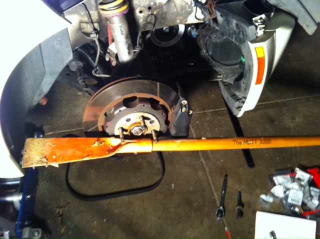

    Here's how I stopped my wheel from spinning during the re-install, which will stop the crank from turning with the transmission engaged as you are currently doing. I've got wheel studs, but you can probably reproduce the effect with your lug bolts.
    You know... if you only jacked up one wheel (Only the front right - I'd bet you have both front wheels jacked up and on jack stands right now), you would stop the tires/hub from spinning with the front left tire and the pulley wont spin... I'm not 100% sure of it, but it might be worth a shot.

    Duh! I'm not so bright... I just re-read my own article for the solution!
    Have someone get in the driver's seat and step on the brake. That will stop the hub from spinning and, with the transmission engaged as you have it, you won't have this problem (foot off the clutch, transmission in gear)!
