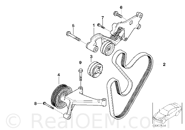

    Well, turns out that after checking with a hose, and judging by the sound its one of the tensioning pulleys, the one on the bottom. (will try to illustrate which part with a photo once I get it)
    Will try to order it tomorrow once I check for the part number. In the meantime the sound stopped with a little WD40 but my mechanic suggested not to wait much longer. :-(
    I will also order the belt and any other items you guys/gals suggest me to get too...
    Thanks in advance and happy Thanksgiving!

  17. k-huevo
    k-huevo Club Coordinator
    683
    159
    Pipe Creek, Texas
    +159 / 0 / -0
    [ame="http://www.amazon.com/Gates-36168-Idler-Pulley/dp/B001FM9WTC"]Amazon.com: Gates 36168 Idler Pulley: Automotive@@AMEPARAM@@http://ecx.images-amazon.com/images/I/313NkjuQ6%2BL.@@AMEPARAM@@313NkjuQ6%2BL[/ame]
    NAPA also has them if you can't wait.
    19,446
    While you are there replace the belt...
  19. minimark
    Just an FYI, Gates makes a replacement belt tensioner too. Thanks Blimey!
