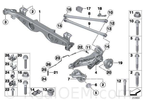

    Toe is adjusted via bracket #7.... Shops not familiar with MINI's may not know the location of this adjustment..... They may not admit that they don't know how to adjust the rear toe on a MINI.... Just saying....
