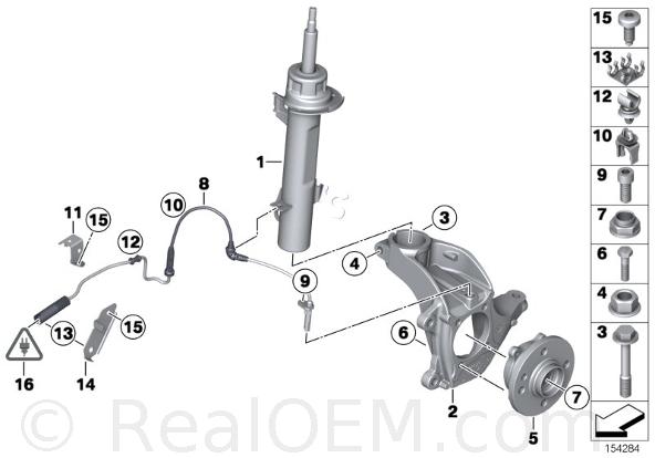

Wow, I had no idea that was going to be so damned hard. First it took over an hour to get the wheel off because MAG over torqued one of the lug bolts. Had to be over 300 pounds because we rounded out my lug wrench from the back of the car, busted a breaker bar and broke a socket in our efforts to get it off. After finally getting it off we discovered that the nut on the hub assemble cannot be taken off without ruining it and I need to get another one before we can finish the job. Does anyone know the part Im talking about? Its the nut on the very fron of the whole assembly, its a 32 mm nut with a crimp on the side to keep it from backing off. I need to get another one of these before next weekend. On the bright side, we should be able to get it done much faster next weekend.
That nut has a thin rim that lets you "notch" the material into the slot with a chisel... Keeps it from backing off after this nut is properly torqued.... You should be able to take a drift and bend the depression back out so the nut can be removed... Your choice if you want to reuse it..... MINI recommends replacing with new as they consider this nut a "one time" use nut....
No reason you can't reuse that nut, just take a small cold chisel and knock that tab back out of the slot, then remove the nut as normal. When you put the nut back on, re-torque it properly, then just tap another tab back into place in the slot. I'd be somewhat concerned about that wheel bolt and the threads in the hub, look at them carefully and make sure they're not stretched or damaged from over tightening. Edit: Metalman beat me to it, he must be a fast typist! However, I hear this a lot from non-mechanics.....they didn't realize a job would be so hard or take so long. Remember this the next time the dealer or independent quotes you on a job and you think it's too high.
They actually broke it when they notched it, so I'm not comfortable reusing it. Any idea of the part number so I can order from eminiparts?
